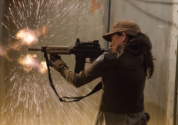

            Get yourself any 'ol flat top AR and dress it up with Magpul furniture, done.

              Flat top AR
              C-MORE Tactical (https://cmore.com/tactical.html)
              Magpul FDE MOE furniture, Black PMAG (Gen3 due to ridges on edges?)
              PWS FSC556 (http://primaryweapons.com/store/prod...g-compensator/)
              Gas block w/ rail and some sort of sling attachment point (This one?: http://yhm.net/railed-gas-block-with-bayonet-lug.html EDIT: This one more likely: http://yhm.net/single-rail-gas-block-1014.html)
              And I guess a 14.5" barrel with the FSC556 pin/weld will have to do.
              Can't tell if there's anything remarkable about the charging handle.

                What do you need to clone it? Poor taste and a lack of backup iron sights in a world where batteries are getting harder and harder to come by? I kid I kid, but seriously.

                  That and the FSC directing flash up into your FOV instead of out the sides.
                  Odd choice of C-MORE, getting the one with the integrated rear sight and not having a front post. Maybe one of these should go with the gas block: http://yhm.net/gas-block-mounted-front-flip-sight.html

                    Nice pics. Thanks for the insight. Will have to consider the comments, didn't notice any of the negatives of the build. Guess I was preoccupied.

                      No, it's looks like it could be a good build. This just shows that the prop guys don't operate like a Calguns member
                      The FSC just needs to be timed properly, easy enough to do, and the front sight has a thumbscrew for easy attachment for when those batteries die.
