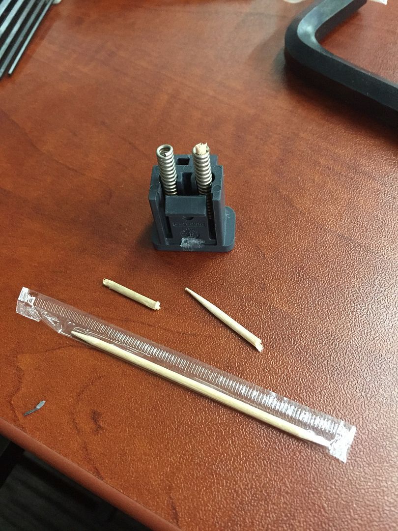

          I did it without drilling into the button at all. All you need is 1 wooden tooth pic. Take off button, break tooth pic into two pieces that are the same length as the springs. Insert tooth pics into springs, reinsert the springs back into the button and put the button back into the stock. Cheap and works. I used the same method on the ACR folding stock with a wooden dowel.

            Right on, thanks for the input. I guess I'll just have to order one and go from there... I was planning on just going MOE, but the Zhukov looks so good!
            NICE!! That's the route I'm going Darthbauer, thanks!
                  Bravo! I like it.
                    MacGyver award for genius!!

                              Originally posted by Darthbauer;17610175[URL=http://s1248.photobucket.com/user/darthbauer51/media/IMG_0847_zpsbxq7sjws.jpg.html
                              [/URL]
                              I know this was a while ago, but how did you actually remove the button? I have this stock, but I cannot find out how you pulled the button off.
