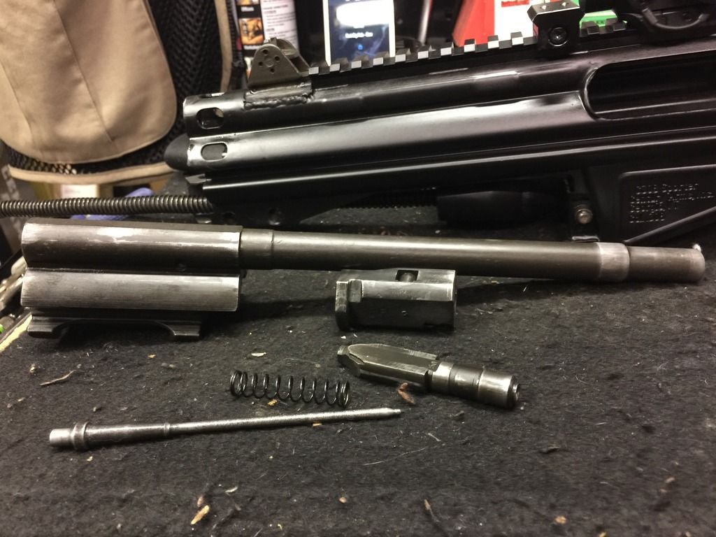

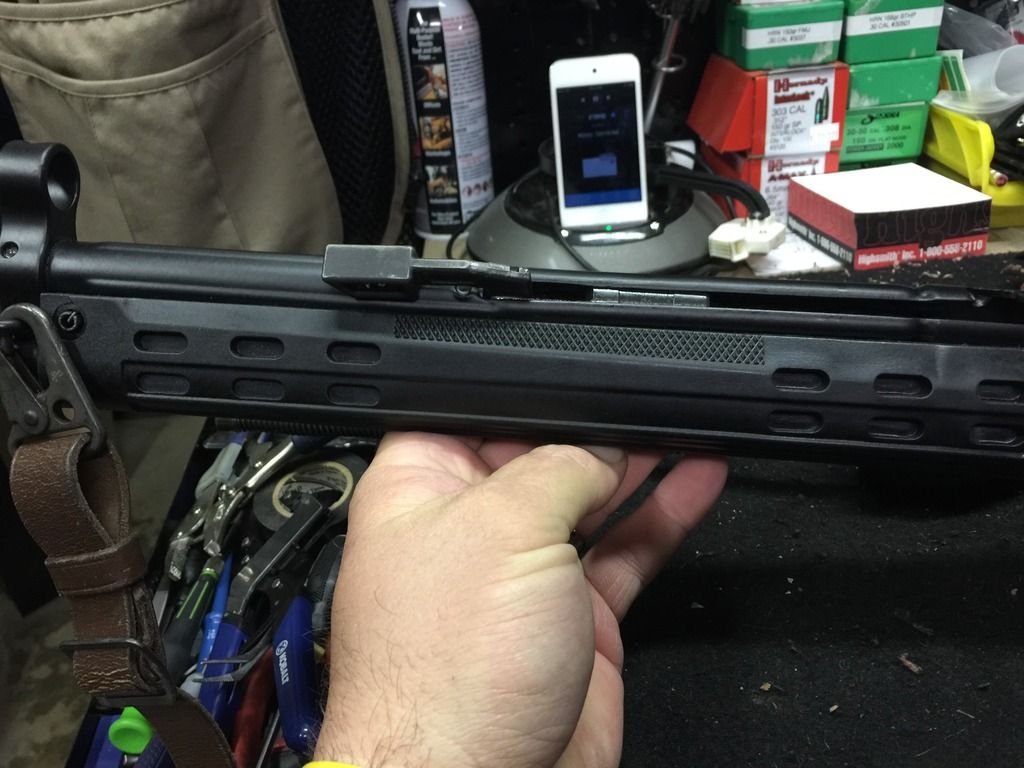

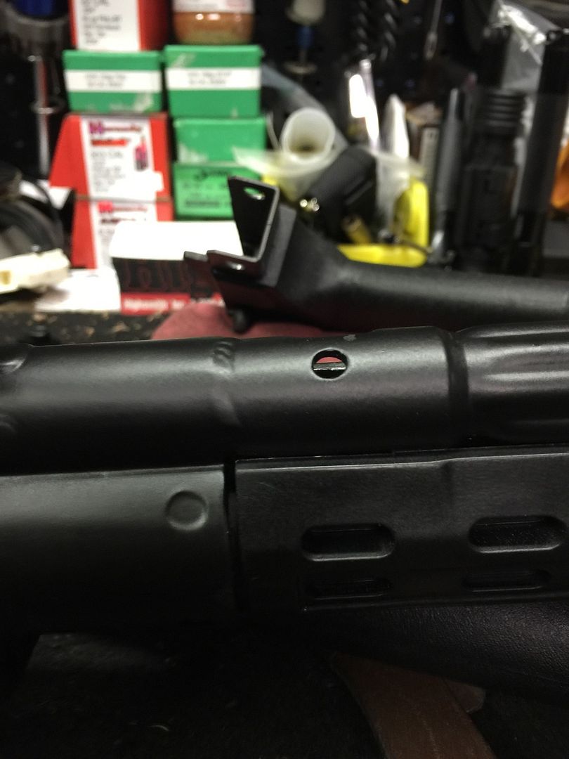

    WORKMANSHIP
    I compared the rifle to a PTR on the rack at Turners and I really saw no difference in quality of the welds or the finish. I also compared the Century rifle to my friends PTR he bought last year. We both believe the rifles are comparable and the addition of the top 1913 rail is much better than the HK Claw mount.
    See the photos below;

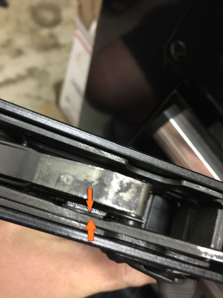

    The next issue I found was the ejector was wobbling in the trigger Pack which can be a common issue with these rifles. I cut down a plastic washer to shim up the ejector and the wobble was gone. The ejector with new spring was moving into the groove on the bolt correctly and I was out of cures.
    You can see the shim below. (Edit, took the advice of seasmoke below and bent the parts with some vise grips to where they should be. Shim is now removed)

    Here are the internals
    Obviously not new. But its fun and with a little work seems to now be ready to Rock and roll.

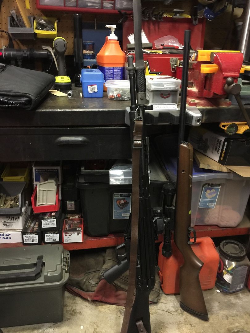

    Here she is put together with bayonet attached (not included with rifle, bought at gun show last week)

      Good write-up and pics, thanks. As to the shim in the ejector slot... most will simply remove the ejector and squeeze the tab back. Use the lever as a guide.

          Thanks for the links, one of the changes i already made was the ejector spring you listed. I am planning on fixing the ejector properly but i didnt want to break down the whole trigger pack. I couldnt get the piece to bend while it was attached. Of course as long as it works why mess with success.

              The ejector is a easy out, remove the spring and then the trigger pack and back the pivot out. A quick pinch (you will know) and your good. Remember, the vertical geometry of the ejection lever is key. A bit L or R and you will miss the slot in the bolt. No slop.

                Okay went back and removed the ejector and bent the part with some vse grips tuned the ejector and now we are where we should be. No slop and full engagement of the bolt groove.
                Now if i can get my ammo from j and g on tuesday i will go out and see if it still works.

                        Cool thread, I am still open mouthed at those welds....

                              The rear sight looks a little crap- as in not quite correct. The welds look good though, as well as overall.
