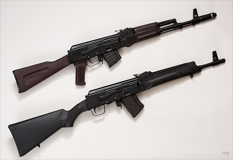

          So this is a converted saiga (looks like the one on top)?
          Saiga are imported in the configuration of the bottom gun in the photo. As imported they (usually) won't work with a standard AK magazine, only the saiga mag. They need a bullet guide to work with regular AK mags, but then your saiga mag will no longer work unless you modify it.
          Typically anyone who would do the conversion to the configuration shown on top would have installed a bullet guide, but it's possible that it doesn't have one. I've used the one from Dinzag Arms, though there are others.
