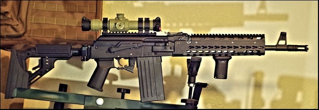

      I wasn't looking for one but it is. With 150gr Norma it'll do 1" from the bench (with different optic).

          Nice! But how ever did you get the Krebs UFM rail to fit on the 308 Saiga? I contacted Krebs a few weeks ago and asked if it would fit and they were certain that it would not.

              Who measures rifle accuracy at 25 pistol line? You? Did I anywhere state that? Did you see me shooting?
              25yd is to initially get a optic on target, that is all I use 25 yard range for.
              I use one of these to make sure there's no room for my error and it's consistent 1". Without it its still the same or pretty close to it.
              As to your assumption, ever since you been on this forum 90% of your assumptions are just that, trolling & talking out of your ___. You actually believe that if someone post a pic of their target its a prof of actual range, ammo, rifle etc? Don't worry, I don't loose sleep over what you assume or believe.

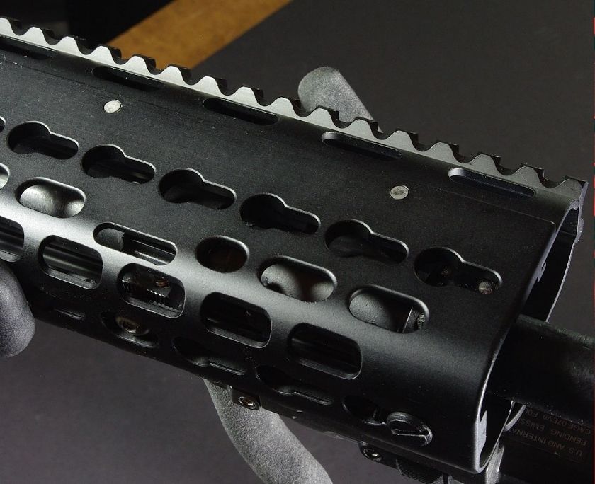

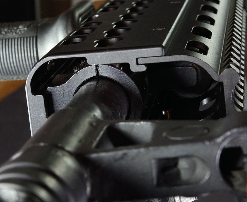

              If there's a will there's a way.
              The handguard is made for Vepr.
              I used two separate mounting points instead of one.. I used metal shims on both of them. The first mounting ring was actually made for CSS handguard, it fit perfect with very little mod.
              Entire set up is rock solid and it's actually more secure than original configuration.

                    Great job! I had thought about trying to do that after seeing the item on CSS about a month ago, but in the end the cost of the project and not knowing if it would work made me decide to go with the DPH Arms tri-rail.
                    Which ring did you go with?

                          Thanks, I used a large one (I though there's only one large version) with some fabricated shims. Small one won't fit barrel diameter as it's made for x39.
                          DPH rail might be nice but I bet it weights a lot more than Krebs. I had CSS rail and it was considerably heavier.
