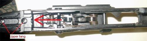

    for my saiga 7.62 all i have to do to remove the buttstock is take out those 3 screws? one on the bottom, and the two on the top? the damn thing wont budge and i looked it up to double check. anyone know what im missing?

    sample of what im talking about:

      While not a Saiga, My Hungarian AK came with a synthetic stock set, and the buttstock was pressed into the receiver and would not budge! I had to use a wooden dowel and hammer it out from the inside of the receiver. Yours might be the same
        okay so i can get pretty rough with it if i have to then? i just didnt wanna mess anything up on the inside and i do think i see the end of it rammed into th receiver.

          insert wooden dowel or the butt of a screw driver where the red arrow is pointing, which should touch the end of the stock and hammer it out.

            I had to give mine quite a few hard hits before it came out, so go at it!
