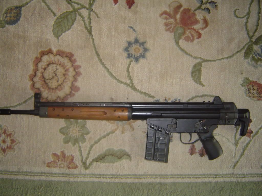

            Cetme
            Heres mine
            *DISCLAIMER* I probably misspelled alot of things, and i dont care...
            "If you wish for peace, prepare for war."
