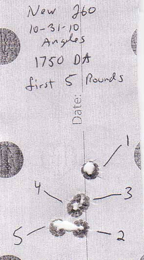

                            Here we go, dug up the old thread:
                            ... in my experience, carbon barrels will generally have similar accuracy to a barrel equal to the steel part of the carbon barrel.
                            The problem with carbon wrapped barrels is that the steel part expands more than the carbon part so as soon as they heat up, they lose the benefit of the carbon and begin to act just like the thin barrel that's inside.
                            Now, if the barrel inside is a really nice and straight one, you might not get the typical thermal drift.
                            However, if the barrel inside has some curvature in it like most barrels, then you will get the typical featherweight thermal drift and group sizes that open up notable from shot #3 and beyond.
                            Just for fun, start marking your shot numbers on every group.
                            As you shoot each shot, record where each shot went and then go mark the shots on the target when you retrieve it.
                            An example:
                            Shoot 5 round groups.
                            What you should watch for is the later shots to be the shots that are effecting your group size.
                            Experience with how fast/much you shoot the barrel will teach you what the limitations are when you start tracking individual shots.
                            Another thing you could do is to shoot 5 rounds at a time on this target, 1 shot per dot:
                            www.caprc.com/targets/10dot.pdf
