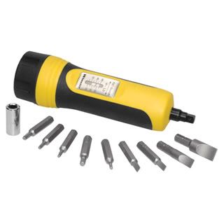

                              Mounting a scope requires a torque wrench or gauge for best results, as do action screws. I use a precision torque gauge, but a torque wrench will do fine. Good ones cost $100 to $200 or more.
                              Clean all the parts with acetone or other solvent, especially the screws and threaded holes, then use a toothpick to apply a miniscule amount of oil to the threads and torque to the proper setting. The scope will not slip thereafter.
