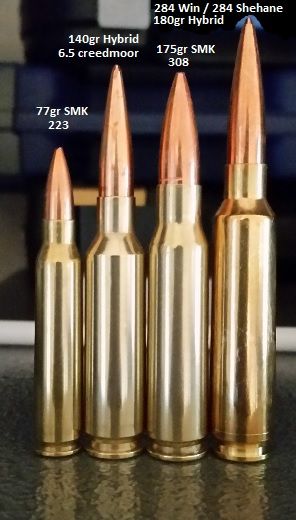

    Off to my next project...a lightweight, tactical rifle that will serve for:
    * Hunting
    * ELR
    * Tactical
    I have a 284 Shehane (a wildcat of the 284 Win, with 0.010" blown out cases for a little more boiler room and higher velocities) and for some reason, the 7 SAUM is just calling out to me. However, I constantly get put down by the fact that the 7 SAUM ballistically is not that much different than the 284 Shehane variant. Its probably 50-150 fps faster than the 284 Shehane, which to me, is not worth it since I will need to have new dies, expensive brass, barrel life will be an issue if I shoot a lot and everything else that goes along with building out another rifle in another caliber.
    Am I missing something as far as its advantages over say the 284 Shehane for my intended purposes?
    The next step would be choosing a SA or a LA. I know a SA could handle a 284 Shehane, but thinking that a LA is probably better for more versatility since I have a SA already. Is a LA the way to go? Going to primarily use 180 gr hybrids
    I plan on doing a Proof barrel WITH a brake, Deviant Hunter action, and CF stock.

                    but the 180s poke out of a 284 case just as nice

                        Mine is chambered with a freebore on the short side, but was spec'd out by Kiff @ PT&G for the 180 hybrids. I think its a .188 freebore. I see a lot of posts with guys running 180 hybrids in a 284 Win / 284 Shehane chambering and they're running in the .200"-.225" range.
                        I'll know tonight what my freebore truly is since I'm getting it back from Alex @ Masterclass today. Im hoping I dont need to get a uni-throater since I do want to load my bullets with the bearing surface above the "donut" region. I rather not ream out the donuts out From my research, jumping the hybrids seems to be the ticket with 284 Shehane in the 0.010"-0.030" region.
