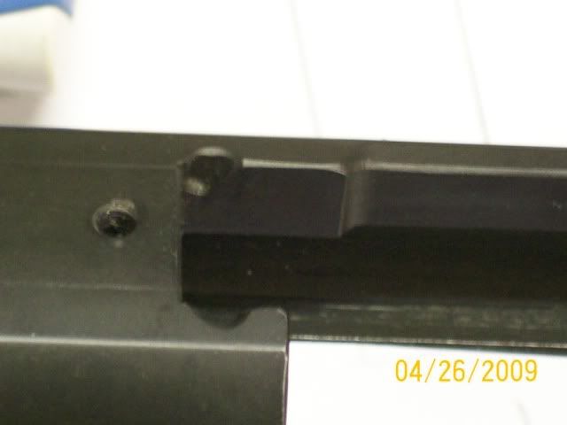

            kendog4570
            • 5180
            Originally posted by mydogsmonkey
            from what i've heard, the 721 is just a clip slotted long action 700 so it should work, but i'm not 100% on this.
            It is not actually a clip slot. It is a cut through the bridge and called an "ammunition guide" by Rem. Not wide enough to receive clips nor has relief cuts on either side of the slot for clip depth stop. I believe it is a byproduct of broaching or shaving the back end of the mag well.
            Standard US Springfield type clip slots run .574"+ wide, the guide slot on 721's and 722's run approx .520".
            I used to cut them in Win and Rem actions for clip loading for rapid fire stages in NRA Highpower. Now do an occasional one for guys building USMC M40 clones.
            Here is a pic of an incomplete 40-x type slot for an M40 clone.
            Here is a complete one for a X Course gun. The side cuts control clip depth, and also, if properly dimensioned and cut, force the empty clip up and out of the slot when the bolt is closed.
                Someone used to sell an aluminum clip slot adapter that was held in place by the tapped screws the receiver for a scope mount. I had one on my Winchester 70 back in the 70s. It was pretty slick. Haven't seen 'em for sale since then.
                  kendog4570
                  • 5180
                  Those would work on long Remingtons and standard length, non-target Win 70 actions when converting to 308 length rounds. Short Rems and Winchesters need the slot cut in the bridge.
