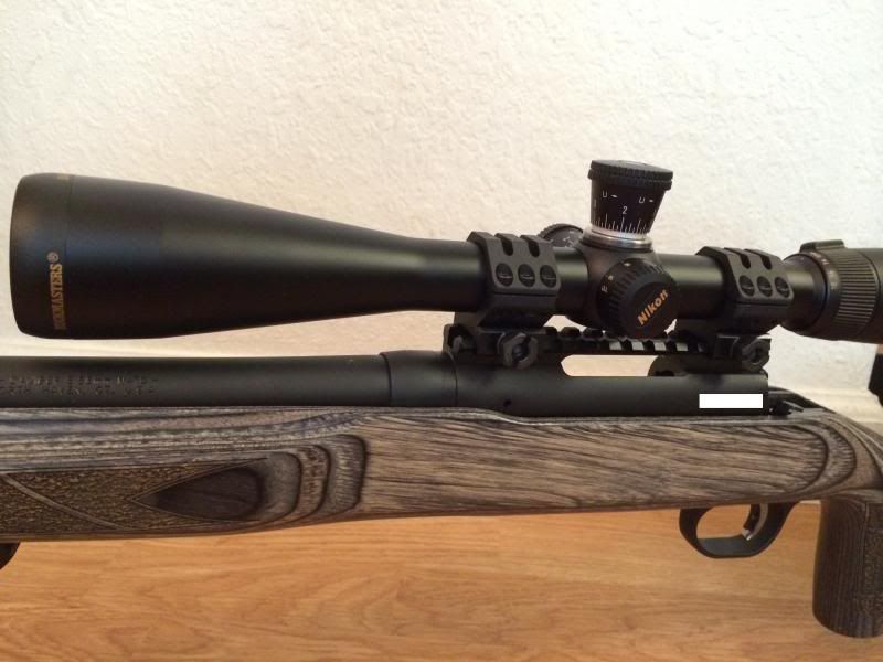

            Just got the base in the mail. Purchased from eBay.
            Sits nice and flat.
            Mounting a Nikon Buckmasters 6-18x40.
            Right now, I have a set of UTG Low rings which have a ring height of 10mm. With this combination, the space between the scope bell and the barrel is approximately 10mm. A little high for my liking.
            Looking at a set of Burris Xtreme Tactical Low rings which have a ring height of 6.35mm. This will bring the space between the scope bell and barrel to about 6.35mm. A little better.

                        • May 2013
                        • 271
                        Mossberg MVP Varmint
                        UTG 1-Piece Scope Rail
                        Weaver 1" Tactical Picatinny Scope Rings Medium Height
                        Bottom of scope bell sits exactly 7.5mm or <5/16" from barrel. The lowest 1" Weaver Tactical Rings were the Medium height (.280" or 7.11mm). I could go lower with the Burris Xtreme rings with a height of .250" or 6.35mm, but I am happy with my cheek weld.
                        I should also note that the UTG scope base is about 5mm higher than the stock 2-piece bases and by using any of the rings mentioned with the stock bases will achieve different results.
