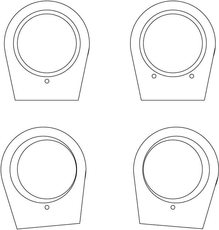

                              Only one pin?
                              You are relying on the fit of the lug to the barrel as the second alignment point.
                              Hopefully those are fitted really tight.
                              I use two pins so I don't have to rely on the lug/barrel fit to locate the lug.
