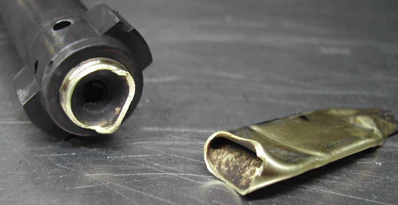

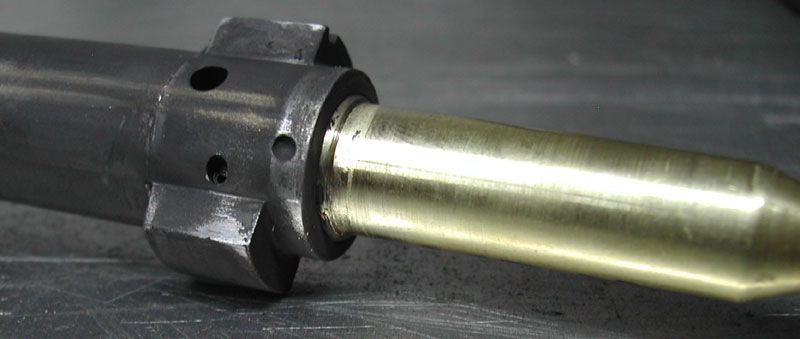

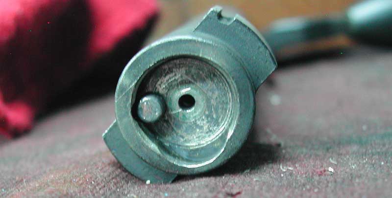

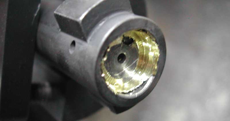

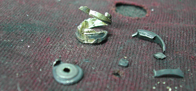

                    Go read about the Remington 700 3 rings of steel and then explain why you would want to get rid of that on your rifle.
                    That's the results from a roughly 160,000 PSI overload.
                    After removing the case and extractor/ejector from the bolt, I checked the headspace and there was no measurable change.
                    I had the bolt and reciever penetrant die checked and no damage was found.
                    I put the gun back together with a new extractor and ejector and it still shot to the same point of aim.
                    The 3 rings of steel are a real thing.
                    No bolt with a cut through the front of the bolt nose for an extractor will survive such abuse.

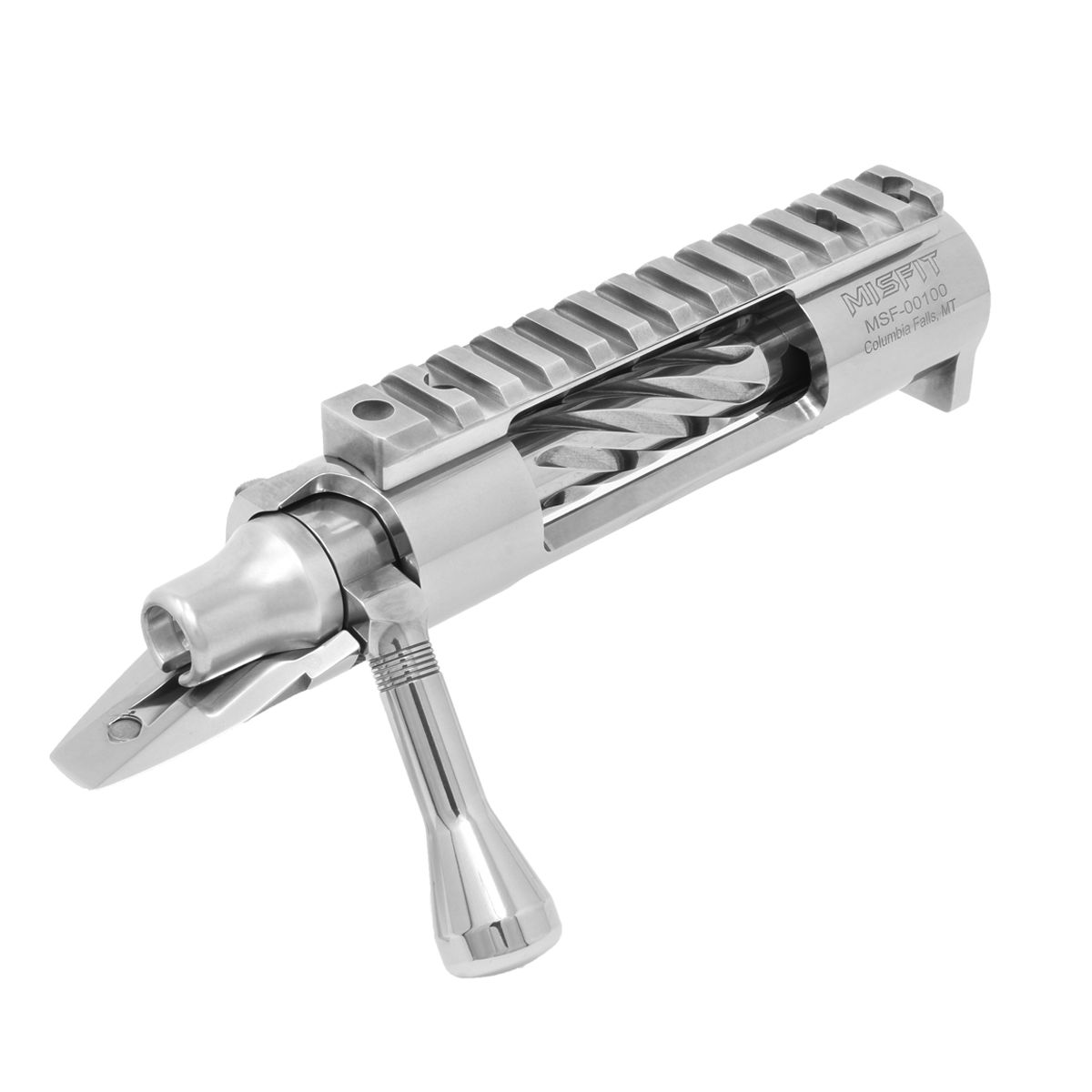

                          Defiance Machine has a new action for $1100. Looks like a good deal.
                          The Misfit - Sets Itself Apart From Other Entry Level Actions The Misfit is the ideal action for an entry level shooter looking to make their first custom rifle on a budget. Built using the same aircraft-certified materials and processes as our other steel actions, but with a limited set of features and options, we are
