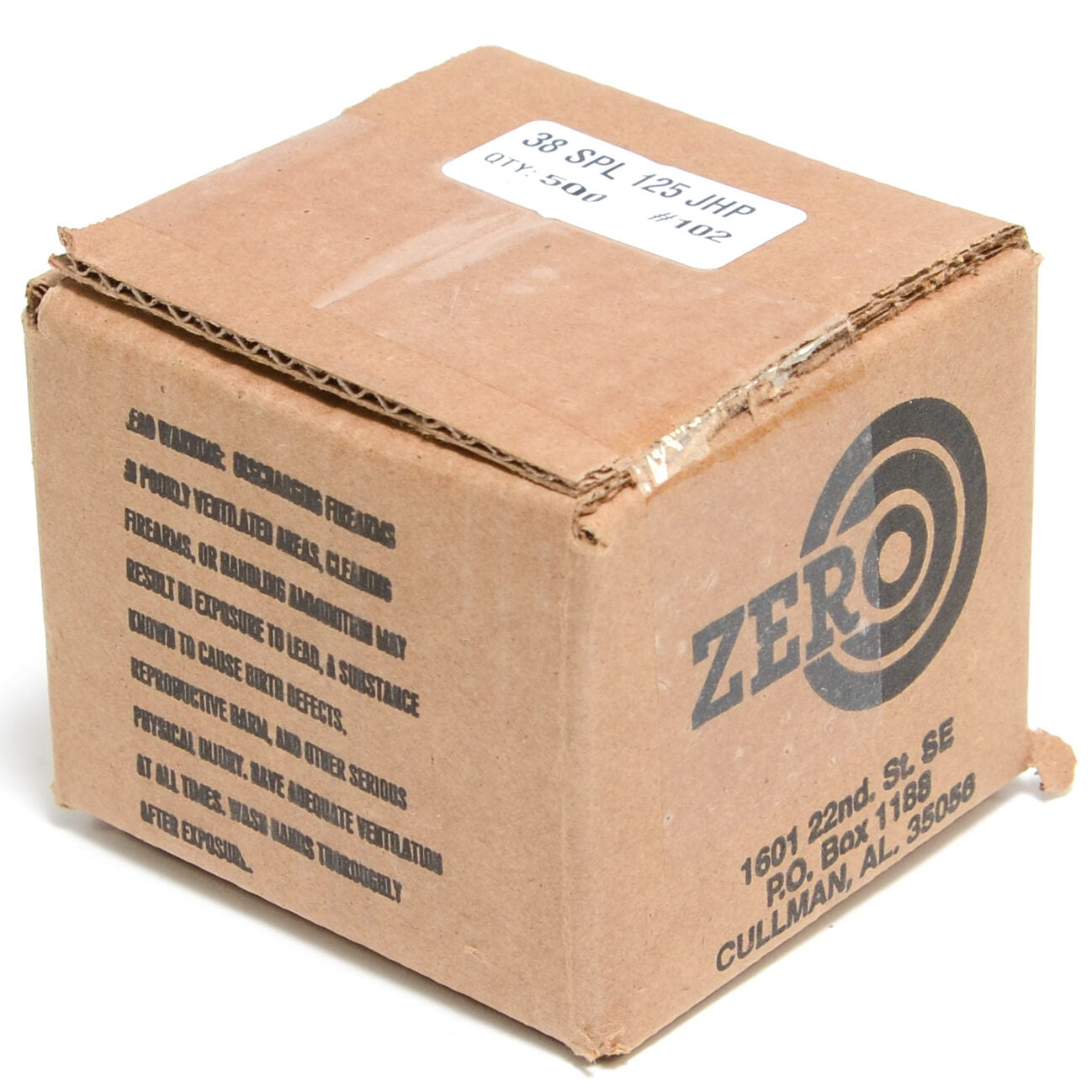

                            I made up a batch using this bullet
                            Zero .357 / 38 Special 125 Grain Jacketed Hollow Point (500) WARNING: This product can expose you to Lead, which is known to the State of California to cause cancer and birth defects or other reproductive harm. For more information go to - www.P65Warnings.ca.gov.
                            They work out to 11.52 cents each. That is about half the cost of an actual XTP. It is still a bit more than that Bear Creek groove-less RNFP which are currently 7.9 cents each.
                            I made a dummy and it cycled fine. The listed load has a COL of 1.575, so well under the max for 357mag. I hope to try them at the range this weekend.
