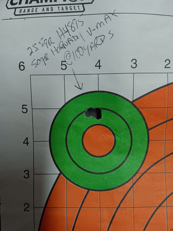

                          As an aside - I have the same rifle, only in a synthetic black stock, chambered for .223. 5 rounds into one big ragged hole at 100 yards. If yours shoots as well as mine, I'd keep it.
