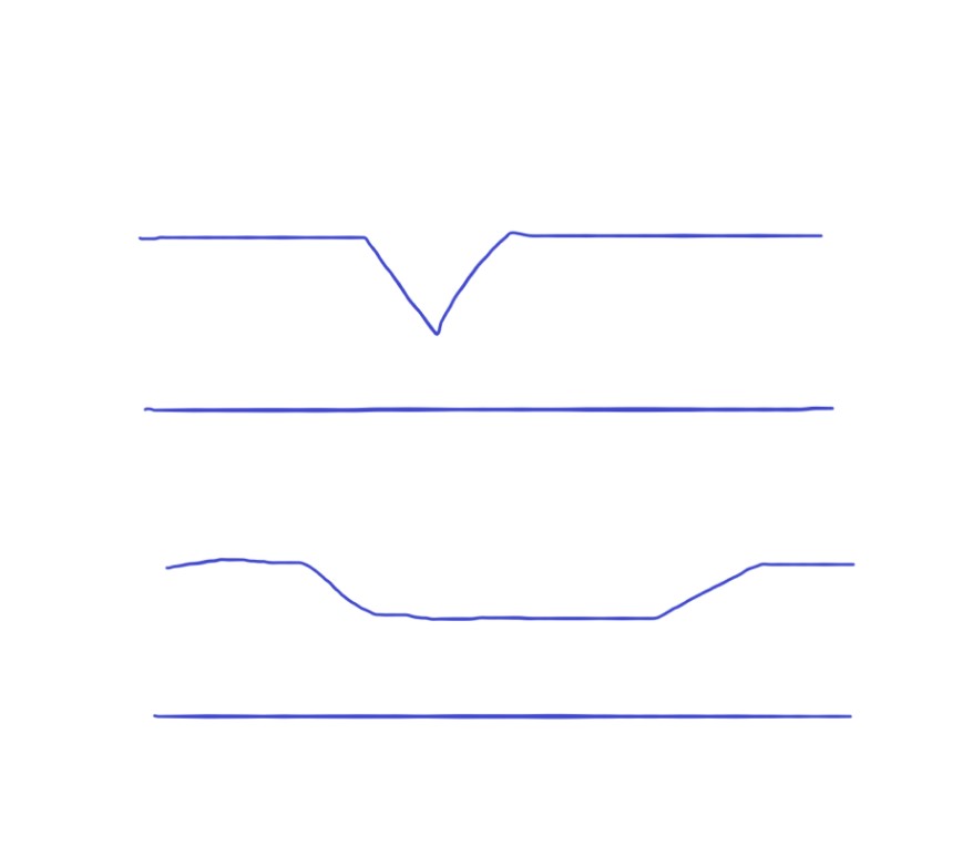

                    That's NOT the correct way to weaken a flat spring as it consolidates most of the flex into one small weak spot.
                    The right way to weaken a flat spring is to cut a much wider area to less depth.
                    That leaves a larger area to do the flexing.
                    Excuse the horrible MS-paint sketch I just did to get the idea across:
                    The example at the top will fail MUCH faster than the example at the bottom while both will have similar tension results immediately.
                      Works okay for me.
                      Maybe I have the old version of Steve's Gunz video. That's the way he does it.

                        Originally posted by golfish
                        Works okay for me.
                        Just because some guy does it that way or because it happens to work for you does not mean it's the RIGHT way to do it.
                        Randall Rausch
                          Works okay for me.
                          Think of it like this, if you file a small spot each and every time the spring (piece of metal) flexes it flexes at that exact same spot. Sort of like breaking a piece of wire by bending it back and forth at the same place until it breaks. If you file a wide area the flex is spread out over a larger area and will hold up much longer. Does this help some?
                          • golfish
                            • 10123
                            I'll make sure I keep that RP loading gate with me just in case the one I notched gives way

                              In all fairness to the Steve's Gunz photo, I enlarged it and it appears to be a rounded base cut, not a "V" wedged base cut.
                              • golfish
                                • 10123
                                Yeah, he does it on a bench grinder if I'm not mistaken, he does it more like the diagram above. I had an old video of his from way back, I think I sent it out too members here one too many times and it never found it's way back home.
