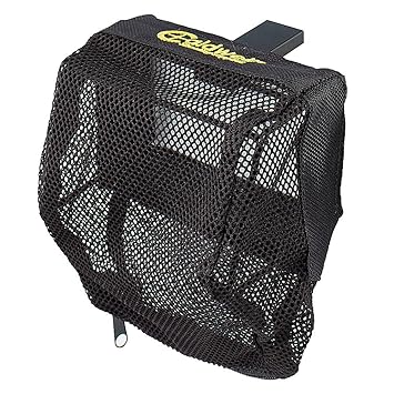

      As for brass hunting, attaches to Pic rail:

        as for the brass catcher, thats a no go for PRS or any competition for that matter
        - safety concern
        - no easy way to clear jams
        - won't allow for ideal positions

            That was a joke, son.
