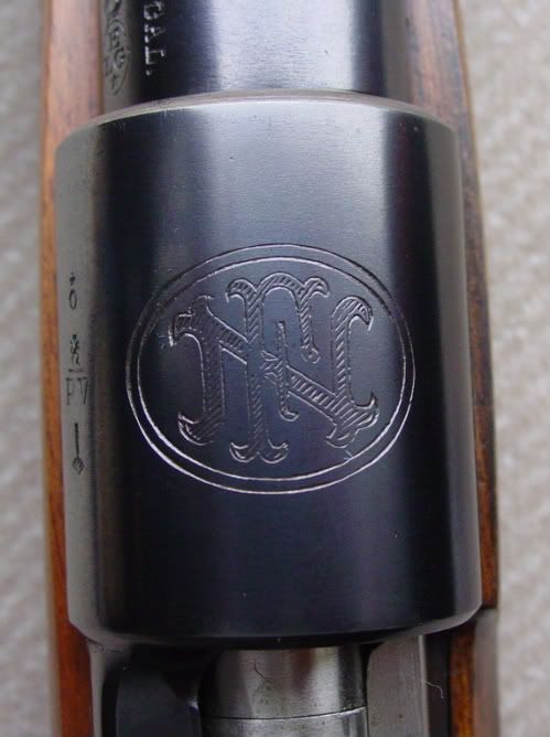

                    Below are some pic's of a FN made action in a custom rifle. You can see the differences in the side rail markings as well as the lack of the thumb cutout on the left side of the receiver. You can also see the commercial FN crest which is surrounded by two ovals.
                    Additionally on the trigger guard and cocking piece you can see the FN date code (1 partially surrounded by a box.) this indicates the parts were produced early in 1951.
                    The fit and finish of the FN commercial actions is readily apparent.
                    Interestingly my rifle's action was proofed by the same fellow (Charles Watrin) as your rifle!!
