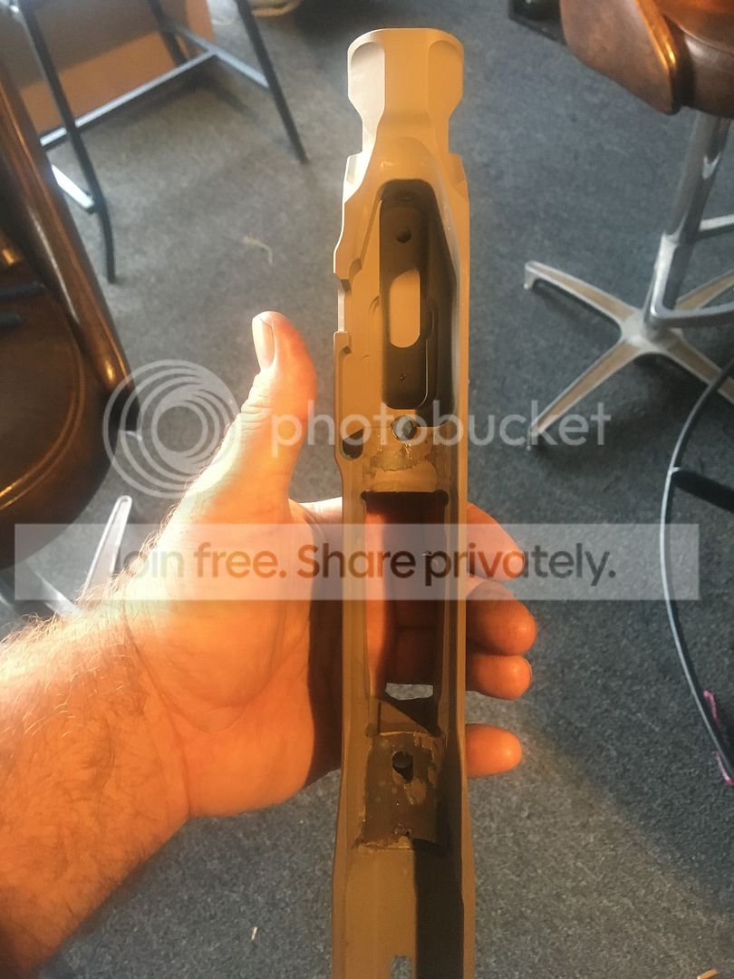

    Depending on the product used for bedding, after about 1-2 hours it becomes somewhat stiff like taffy. At this point, I'll clean up the excess with a sharp popsicle stick or razor if necessary.

          Was there a problem with the chassis? I'm sure MDT would have replaced it if there was a defect that prevented it from fitting to the action properly...

              Those pictures are a little small.

                    So the back is super thin, and the front gets thicker toward the lug. The lug was wrapped on sides, so I know I have proper clearance. Popped right out, with minimal cleanup. Not super pretty, but seems like a solid job. I’m happy. Now onto the scope, and getting it lined up proper.

                        did you do any kind of prep work to the surface of chassis before bedding? and what did you use to bed it?

                            Even a skim bed needs something to mechanically lock into unless the caliber is not much in recoil department.
