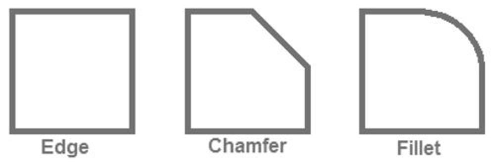

              Originally posted by DDRH
              Can I ask you for a photo of your bolt firing pin hole?
              Many factory 700 bolts have an excessively large chamfer where the firing pin hole passes through the boltface plane.
              The 308 bolt below plainly shows it.
              That excessive chamfer allows the cratering you are getting.
              The solution is to bush the firing pin hole.

                  DDRH
                  • 2756
                    ar15barrels
                    • 57172
                    You want an edge on the hole, not a chamfer or fillet.
