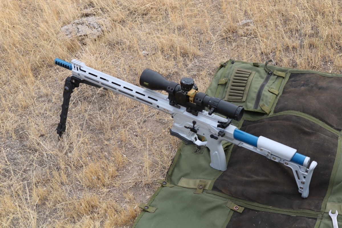

                  here's just one more instance where a nicely contoured, button rifled and hand lapped chrome-moly barrel outshoots a PROOF: (the CMV barrel is onle 3.5 ounces heavier...and 1/3 the price)
                  Who doesn't love America's favorite rifle — the AR-15. For the last few years, the AR-15 has rapidly become the 1911 of rifles. There are options for customization so thorough that companies like Brownells now ship a special catalog just for the options available. And every time I think everything possible has been done, a company proves me wrong. This week, Cobalt Kinetics shipped two models of rifle for testing, and I was not disappointed.
                              https://www.gunsamerica.com/blog/b-m...s-full-review/
                              That's not exactly definitive evidence. The guy shot one load through the guns, and the steel barrel shot only slightly better, and I mean slightly. A true test would include several factory loads and maybe even some handloads. He also acted like the Black Hills load that he tested was something special and would produce guaranteed excellent groups. I've had guns that shot 2" 3-shot groups @ 100 yards with BH match ammo, but the same guns could shoot well under 1" with other factory loads. I'm not saying that I dislike BH ammo, because I do like BH, but accuracy with factory ammo is never a slam dunk.
