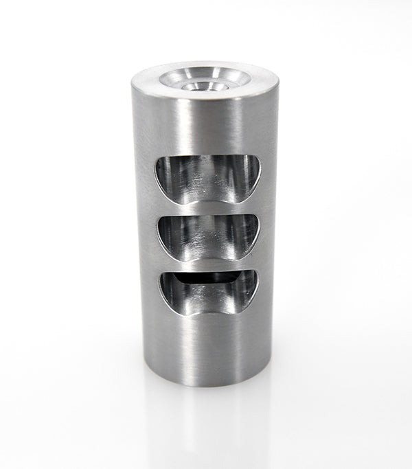

                I put a Ross Schuler 3 port on my Remington. I love the flush fit and the price is hard to beat. $45! You will need a gun smith to thread your barrel, but thats easy stuff. If your close to Randal, he can do it in a few hours and you walk out with your gun.
                I've since threw some black spray paint on it, just to make it blend in better.
