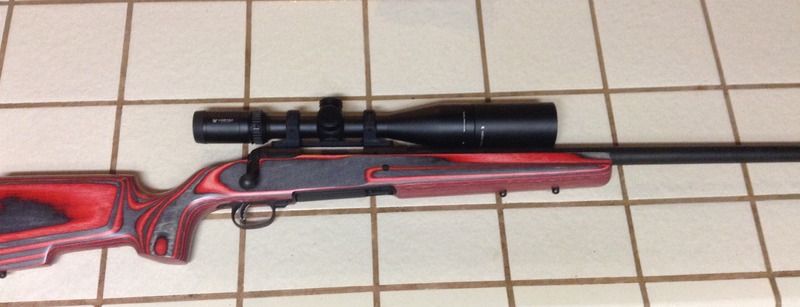

    My boyds stocked savage 11
    Sorry terrible picture, but it seems to be a good stock. Maybe little more " floating" in the tang area.
    Was not a "drop in" had to remove quite a bit from the forearm. My savage 11 is a heavy barreled rifle. It is a $200 stock and I wasn't expecting the world.

    Very nice. Take it to a smith for a good bed job. That will improve it even more.

          I like that! I think it was your thread that convinced me to do mine.
          My bottom "metal" fit really well. Just opened up the barrel a bit and
          A little work around the tang.

            Nice, I like the shape. What model of stock is that?

                Pro varmit.........I believe it is the old tacti-cool model

                  If anyone is interested I "opened up"/ widened the fore grip with a 7/8 dowel about 4' long and 60 grit sand paper. Double wrapped the paper for the last widening. Brownells was out of stock with their tool for the widening.

                    Thanks. I need something just like this when I restock\ re-barrel my Rem7.
