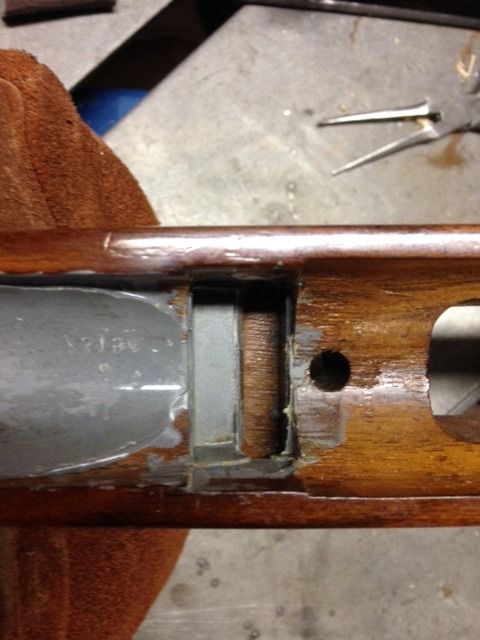

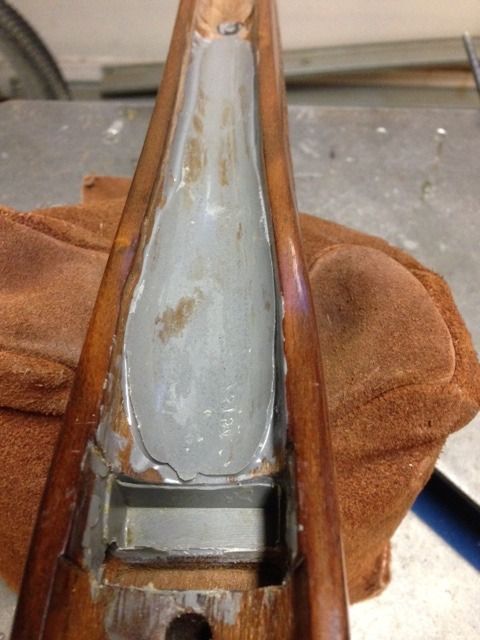

    I read all I could about what guys were doing to bed their sporters. I finally gave up my stubborn streak, bought some Clear shoe polish, modeling clay, and JB weld.
    After my research on sporters with 26" long whippy barrels I opted to go for bedding the barrel 3/4 of the way down fore stock, in the recoil lug area, at the front of the action and receiver area and joint, and the only solid area aft of the magazine inlet. I couldn't do the back tang on the Nikko. There just isn't any area solid enough to build bedding to.
    So here is the finished product
    From the Front - barrel is about 3/4 contained in the fore grip
    Recoil lug area looking forward

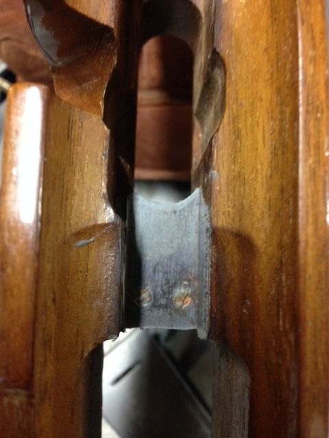

    Recoil lug - note the thinness on sidewalls, The inletting job was very good, but not good enough I guess!
    Area just behind magazine well. The was the only area I could bed on the action besides the recoil lug...Note how thin the epoxy is on the sides again, not much to give, but enough to jack up the rifle.
    I took the gun out yesterday to West end. I am glad to report it performed more like a real rifle. I shot two groups of 5 rounds each and the gun has gone from a 6 moa rifle to a 1.5 moa rifle. I didn't wait for the barrel to cool, or do any other protocol to help its chances. I held it tight, loose, on a hard bag, soft bag...it didn't really care. I tried different weight bullets, and while the POI was slightly different, the gun shot consistently!
