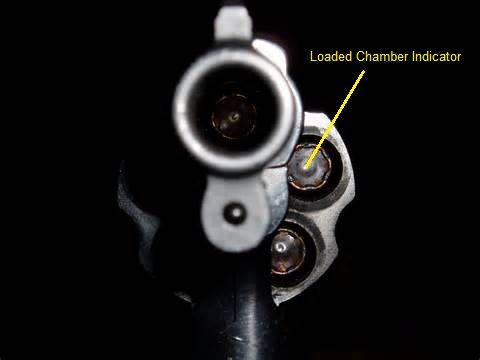

                I've never had a problem with loaded chamber indicators:
