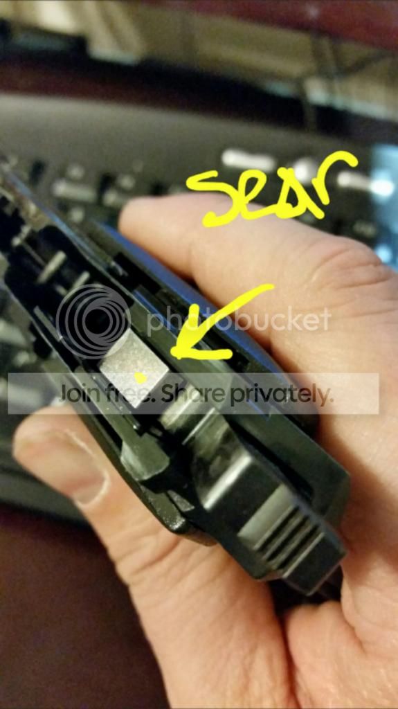

          If you field strip it and pull the hammer back the sear lifts upward a little bit. Check to see if the is something in there. [IMG][/IMG]
          You maybe able to clean that area without having to do a detail strip.
