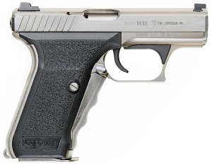

                      No, it draws from the best aspects of Helmut Weldle's HK P7. But it is fundamentally a completely different pistol in operating principle. The P7 is a gas delayed gun, this is a tilting barrel gun. The P7 is a squeeze cocking design, this is a single action only design with a front safety lever.
                      Ok so it's a P7 and you changed a few things

                        Nice work, but REALLY didn't like the whole HK P7 front strap thingy when I tried it, and that was before I really got into guns (but I was using various nail guns, drills, saws etc with triggers all day long).
                        This might sound dumb but in spite of what everyone was saying about ergos I was thinking "what if my fingers get confused" since it seemed like it had basically two triggers.
                        Doesn't surprise me no one ever made any more.
                            HK thought of that too. The P7 series will still fire if you were to pull the trigger first, then squeeze cock it second, however the squeeze cocking action is heavier doing it that way.

                              I appreciate your cad skills. I think if you continue down the design path with this, you would find the locked breech tilt action design you are proposing for the pistol will result in a larger slide physically than depicted in the drawing.
                              As I'm sure you know, one of the P7's great attributes as a gas retarded blowback design is its minimal slide dimensions. Of course, it's Achilles heel as a range hose is also the gas retarded blowback design, but it wasn't built with that usage in mind.
                              The P7 isn't made anymore for one simple reason. It's not financially advantageous for HK to do so any longer. It is now a legacy piece, like the P9s.
