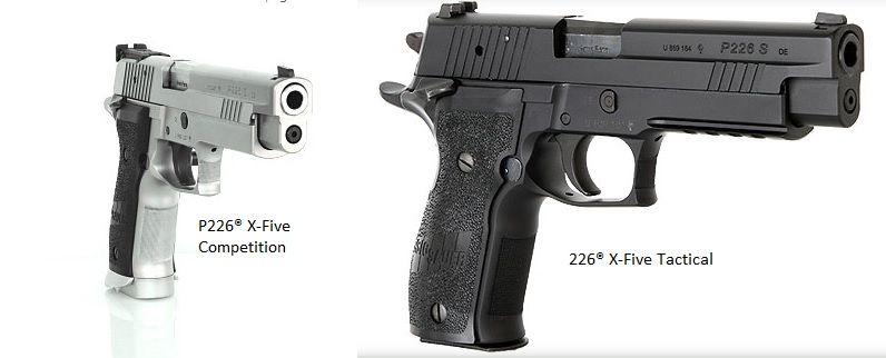

              Some models have an added part to guide the magazine into the magwell that I referred as the "funnel".
              See the difference between the X5 Competition and the X5 Tactical:

                        As mentioned the standard P226 mags will fit the X5 models. The old style X5 models such as the X5 Comp and L1 models with the funneled magwell will fit but since the magwell is not removable it makes it very impractical to feed the standard mags.
                        The new X Series or X5 enhanced models allow you to easily detach the magwell with an Allen wrench so it makes using the Standard mags extremely easy.
