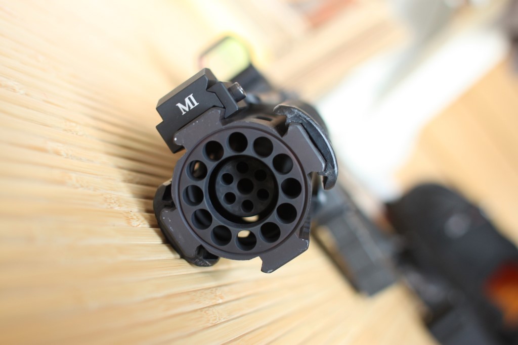

    specifically (not saying I am doing this) I have seen AR pistol barrels that are "recessed" in a free float (eg. 10" barrel inside a 12" free float).
    would the pistol then be measured from the end of the buffer tube to the end of the rail...or the barrel?

            so in this instance:
            to the tip of the barrel? or the end of the rail?
              End of the rail.
