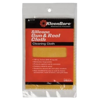

                            Silicone gun cleaning cloths, I will have to try those any particular brand?
                            I will pay better attention next time I fire it. I will bring a few different brands/grains to see what it prefers.
                            Not sure what Kruzr uses but Hoppe's #9 is kind of a staple general purpose gun solvent.
                            In regard to silicone gun cleaning cloths just about any will do, I seem to have more of these than any other kind as I look around:
                            In over 40 years of firearm ownership I've never had any rust or corrosion on a firearm which I've wiped down with these types of cloths after handling. I can't recommend them enough and I'm shocked at so many gunshops nowadays that DON'T wipe guns off after customers handle them. I can only assume it's lost knowledge to the synthetic and stainless generations.

                              trigger945
                              • 5795
                              Good to know about that silicone cloth redcliff! I have only used it to clean my revolver. I never considered (and I don't know why) to use it to wipe down my handguns after handling.
