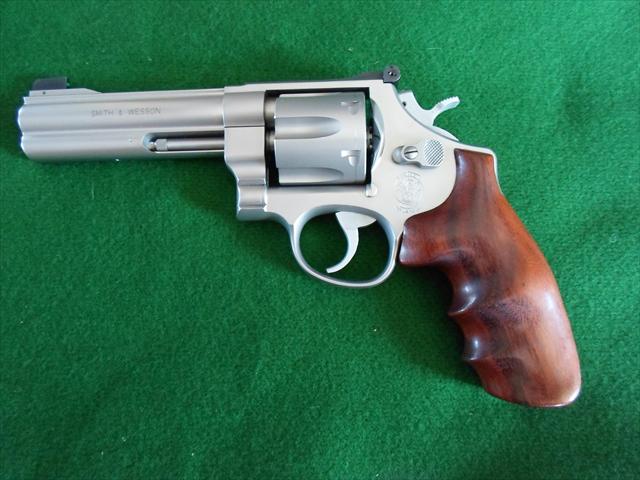

    I'm a big fan of S&W unfluted cylinder revolvers and am also feeling the need for a .45acp version. Unfortunately, S&W doesn't make this exact combo. I'm looking to buy a 625 and swap out the fluted factory cylinder with this unfluted factory cylinder I found on Numrich.
    I am aware that cylinder swaps need to be timed and have the barrel gap set. What does this involve? Can a novice gunsmith such as myself take this on? Can the original extractor (already timed) be reused?
    Alternatively, can anyone recommend a SF Bay Area smith to do this work? Got any ballpark estimates what this work will cost me?
