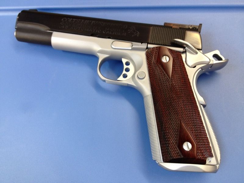

    Looking for a place in the Monterey or San Jose area that will hard chrome my CZ97B. I saw this picture today and was just blown away. I want mine to look like that but i don't want to ship it out, I want someone local that I can drop it off to.

    Do you mean nickel plated or CHROME, like gangsta?

      I don't know of any reputable local hard chromers. In fact, I think a local smith would just send your gun out to be hard chromed...

        That pistol is chrome plated with a matte finish.
            Gangsta is decorative chrome, like a bumper.
            OP means engineering hard chrome, where the plating thickness is carefully controlled so the gun works after plating.

              Metaloy is who most of the 'smiths use. I'd pony up and ship it.

                These guys spun off from Fail Zero years back....
                NiB looks similar and is very similar to the Robar finish.... Looks similar to Chrome but is more durable and resistant to rush that can destroy chrome...
                If you have ever thought of upgrading your gun, obviously have it done before refinishing... Beaver tail, serrations, etc

                    Originally posted by jessegpresley
                    Are you sure that's hard chrome and not a electroless nickel like Cera-Plate or NP3?
                    CCR Firearm Refinishing services, quality craftsmanship at an affordable price. Refinishing of handguns,rifles,shotguns using Cera-Hide a teflon/moly based ceramic coating.
                    http://www.robarguns.com/np3.html
                    Yup, 100% sure. I read the old post where the owner listed all the upgrades. I called the guy who he used to plate it and they told me they no longer finish pistols. Thats when I started look locally.
