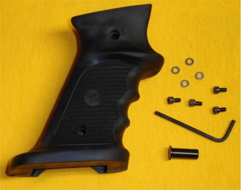

          It's not a slip-on grip, but I've got a Hogue wrap-around that has finger-grooves and a thunbrest. Installs quickly with a screwdriver and they are inexpensive.
          Pic of them on my MkIII:

              Kicking rad! Thanks for the input! Numrich doesn't have the 22/45 frame listed, but that Hogue wrap-around looks awesome. The Volquartsen also looks to be a good option. What is the model number of the Hogue grip? I've only ever seen Hogue grips for the Mk II before.

                Johhny,
                Hogue's website says the model number is: 82060. Their rubber grips for the Mark II also fit the Mark III.
                I can't speak for the VQ grips, but the Hogue's get the job done nicely for approx $20, compared to over $50 for the VQ grips.
