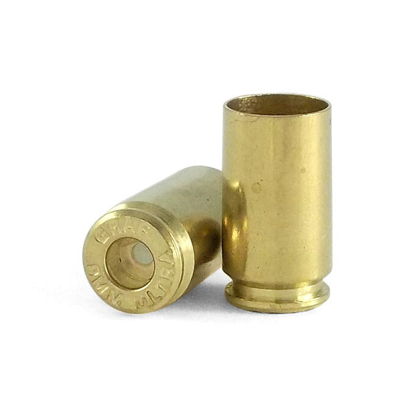

        I would not try 380 due to the headspace being so different.
        Yes, the extractor may hold the case back and the round may fire, but it also may not depending on how the extracter grabs the case.
        Lacking proper brass, i would be tempted to cut down 223 cases to 18mm long and loading a few to try.
        9x18 ultra uses standard 0.355" 9mm bullets.
        For less brass forming work, there's these:
        9x18 Ultra Police. New, unprimed brass. Accepts boxer primers. Made in USA. This is not loaded ammunition.
        The internets say that 9x19 dies load 9x18 ultra just fine with a 223/380 shellholder.
                Yes, the extractor may hold the case back and the round may fire, but it also may not depending on how the extractor grabs the case.
                Re reloading I think I'd use 9mm Luger cases trimmed back. The "internet" also suggests using Makarov cases sized down through Luger sizer die. I can give that a try, see how much extra effort is required to squeeze it down. This can't be anymore of a challenge to reload than the 41 AE.
