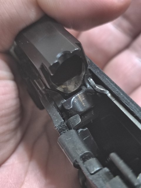

              - Those fancy Hydra shok Deep rounds would not feed at all! At least two failures per magazine - 1st round, last round, or in between.
              - The jacket on those rounds is "crimped" and is intended to peel back upon impact rather than truly mushroom
              - The edge of the crimp gets hung up on the feedramp gap, see mossy's pic in the post above ^^^

                I guess I'm not alone - S&W forum has a recent thread on the hollowpoint feeding problems
                Hello, I am new here but not new to shooting. I posted another thread and received some great advice so I hope you guys can help me with this issue. I have a new Smith & Wesson bodyguard 2.0. Unfortunately, I am experiencing a problem trying to load it with hollow point ammunition. No matter...

                  FWIW here are the relative OAL, left to right:
                  - Federal Hydra Shok Deep
                  - Prvi hollow point
                  - Ball ammo (Monarch steel case)
                  The Prvi and Monarch both ran well, 'Deep' could virtually never feed well. The bullet is very conical and the crinkled edge is just looking for something to tangle with!

                      So I went and bought another BG2.0 today (yes one can do that here in free states.) Wanted to get one without the manual safety. I'll sell the old one.
                      Seems like S&W has addressed the feeding issue, the latest batch of guns has a different feed ramp profile! Old one has a square edge, new one clearly machined a little deeper to reduce the lip.
                      OLD
                      NEW
                            OLD
                            NEW
                            Dam......I'm going to have to check my barrel, got it a few months after launch. I wonder if they will replace my barrel if I have the old one.
                              Well if you have no issues don't worry about it. FWIW I would have expected mine to have all the known issues fixed but it clearly didn't. I field stripped two units at the store I bought my new one and both had the modified feed ramp.
                              But while a light polish might be ok I wouldn't remove any metal if you want S&W to work on it. Their warranty is great if it comes to that, they email you a fedex label and you drop off the package. Free! (Well I shipped a long gun, perhaps hand gun is different...)

                                Well I bought some Federal HST and ran it through the new gun yesterday - about 200 rounds total, 150 of those were HST. Made sure to pack the 10rd mag full and shot with 10+1 each time since that's how I'll carry. No issues!
                                What did I learn?
                                - The round nose of HST works well in this gun
                                - Manufacturing updates to the barrel feed ramp are clearly beneficial
