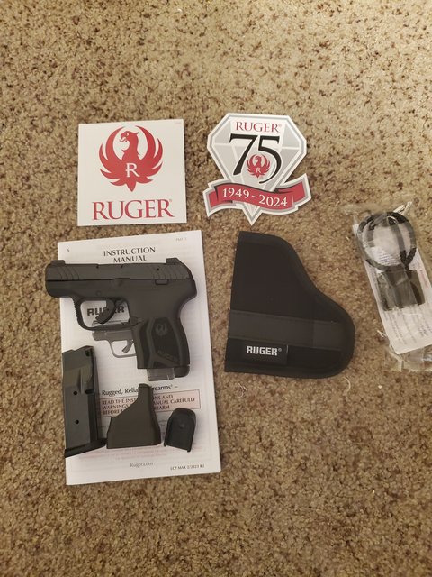

    what's included
    the LCP max comes with one 10 round magazine, a pinky extension for that one magazine, a mag loader that is absolutely required to load the last round, a pocket holster, cheap useless cable lock, some stickers and paperwork.
    I would have appreciated a second mag be included, but I guess that's how Ruger is keeping the cost of the pistol low and getting you to purchase a second 10 round or 12 round magazine after you buy the pistol.

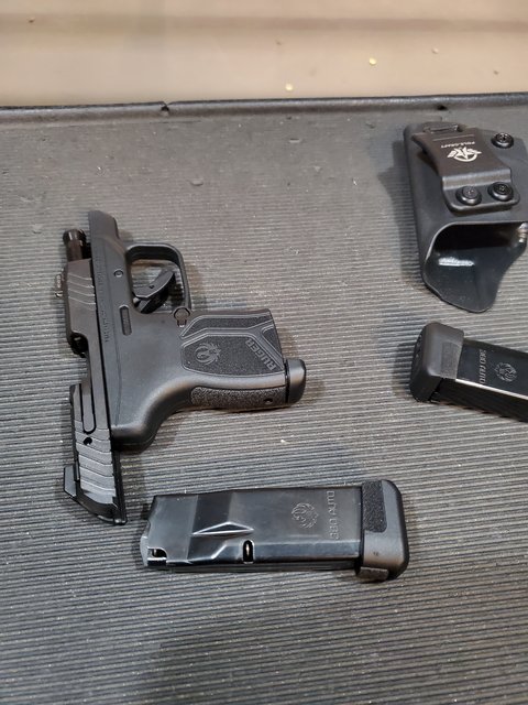

    the gun
    defiantly not a "fun" gun to bring to the range and run 500 rounds. it does make nice fireballs out of the 2 inch barrel, but that novelty wears off quick. I don't think anyone buying one of theses expects it to be fun though. its a small gun that's super easy to carry and has a nice 10 or 12 round capacity. sights are nice ,Ruger didn't cut any corners to save a buck with the sights. they give you a steel u notch rear with a high visibility tritium front. the gun is supposed to accept Smith and Wesson bodyguard sights so if you wanted to replace them you can. the lcp max is a 2 finger grip, 2.5 if you add the pinky extension to the 10 round mag, and a 3 finger grip with the 12 round mag. i just use the 12 round mag because it still fits in the pocket makes it easier to grip and draw wile taming some of the snappy recoil.
    the trigger
    the trigger sucks, its the bast**d child of glock and a 1911............ technically the LCP max is a single action only gun but it does not feel like a single action gun. the trigger has a spur, long take up to a 5ish pound wall then a long reset. i am sure with practice I can get faster, but double taps feel slow with this gun. the trigger also pinches. i have heard that if you replace the trigger with a aftermarket aluminum trigger it fixes the pinching, but I don't see the need to invest any more money into this gun as i am not going to be bringing it out to the range every time I go. i already bought a IWB holster and magazine twin pack, that's enough money spent on this gun...besides if I get into a situation with this gun, I am sure the last thing on my mind will be how the trigger bites.
    me being OCD
    its been reliable at the range, but one potential problem i see with this gun is just how open it is. if you are pocket carrying the lcp max, any dust bunnies/ lint or whatever else is in your pocket can find its way into the gun. the back of the slide has a massive opening for hammer travel so when you look inside you can see the hammer, firing pin and the next round in the magazine. maybe I'm being paranoid, but after I pocket carry the max I alwase disassemble it to make sure its clear of pocket debris. I also sent the first pack of 12 round magazines back to the mag shack, the metal appeared to be separating in the back of the magazines. the replacements I got were much better and the metal separation dose not appear to be present. they are impossible to load without the magazine loader though. they are worse than Glock mags with a +2 baseplate

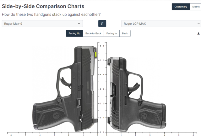

              Seems awfully close in size to a MAX 9 which I have. I also have an LC380CA with 9mm barrel and slide. I don't keep .380 but have many other pistols chambered in 9mm. It is 7+oz lighter though.

                  LCP max is significantly smaller

                        The most important dimension is height which is only 4 tenths of an inch difference. For most holsters barrel length isn't what causes it to print, its the grip length. Very little difference in width. the weight difference is substantial though.
