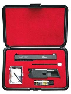

                    Another option is to buy one of the several conversion kits available to convert your .45 to a .22. I bought the Advantage Arms one due to its great reviews and decent price (compared to some of them). I still haven't tried it out yet, but the build quality seems great and people seem to really like them.
