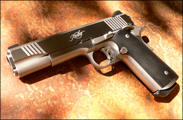

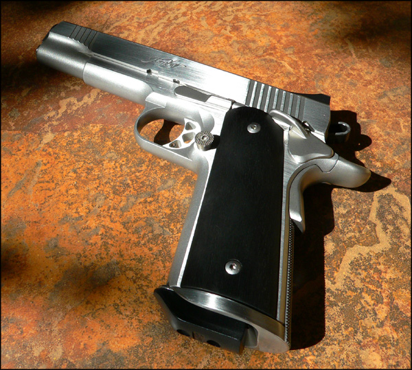

                      Get the EGW firing pin stop as stated. http://egw-guns.com/catalog/product_...products_id=36
                      I have that, and also a Wolff variable 16.5 recoil spring and a Kimber 3.4oz tungsten full length guide rod in my Kimber Stainless II. Shoots like a dream...noticeably softer. I also have the EGW thick flange barrel bushing with the spring plug to go with it, but that's more for accuracy and a tighter barrel-to-frame fit then for recoil reduction. Looks very cool though.
                      This is a good posting I found on 1911forum.com...
                      "Recoil springs do not affect total recoil to any great extent. They can prolong (heavier spring) or shorten (lighter spring) the cycle time of the slide. This in effect alters the way recoil is perceived by the shooter but does not change the total recoil. The easiest ways to decrease total recoil are to add more weight to the gun, lighten your loads, add a compensator, and/or port the barrel and slide. Many of these features are found on "race guns" where the name of the game is speed. Hope this helps."
                      *Given this info, I do think the tungsten guide rod and the magwell I installed helped out somewhat. -Don
                      Notice the thicker flange bushing in the front of the gun?
