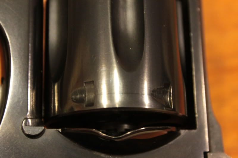

    Can anyone tell me any details on a 25-2 and what they are worth in super nice condition? It's the 6" barrel version, original wood grips.
    PHOTOS:
    Beautiful grips:
    Doesn't look like it has been shot after leaving the factory:

                        Photos added:

                          Great revolver, congratulations. Hard to find in that condition and with case in California.
                          That looks like a 6.5 " barrel to me, not a 6", I have both lengths in 25-2's which I purchased in the late 70's and early 80's.
                          Some of the 25-2's have over-bored throats on the cylinder measuring approximately .455-.457 instead of the proper .451-452 diameter. If yours is over-bored you'll need to experiment a bit to find a .45acp cartridge it likes for maximum accuracy.

                            Thanks Redcliff, yes I was incorrect in the OP when I said it had a 6" barrel. I was surprised to find the warranty card and specification sheet under the tray in the presentation box and it said 6.5" barrel.
                            I have heard of people taking a lead boolit and dropping it in each cylinder bore to check the throat sizes... I have some Hornady lead .45 boolits that I will try that with and check it out. I hope to shoot it either today or tomorrow

                              shooting4life
                              • 5768
                              If it has oversized throats your best option would be to either shoot jacketed or get slightly oversized lead bullets to match your throat. Some of the smaller bullet makers will size on the larger side for you for no additional charge.
