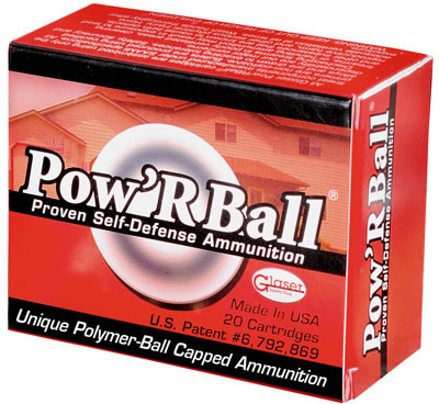

            What about Corbon Power Ball ammo. It has the expansion of a hp with the profile of an fmj.
            Corbon PB45165/20 ammunition is 45 ACP +P with a 165 grain Pow'RBall bullet, polymer ball cap, 1,225 fps velocity, and 20 rounds per box.

                          Powr Ball might be good for this situation... I hear its not as reliable as standard JHP when it comes to expansion, but if it's all that feeds reliably, it's probably better than FMJ for home defense.
