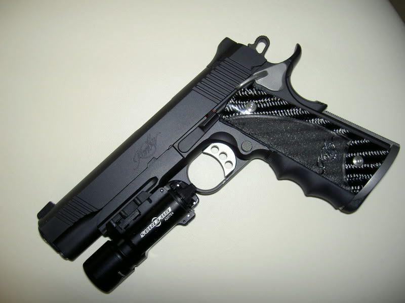

          Here's an Ed Brown, Feels great and a solid product. It did require some minor filling for the FPS, But it is 100%.
