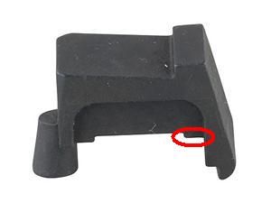

              Very good information. Is your ejector modified for the 10MM barrel/round?
              (grind the bump off?)

                No I haven't modified the ejector on my G21. I read in another thread about that but I don't know exactly what to do or which bump to grind off. I'd like to do that if helps save my brass as it would make me want to shoot it more if I didn't have to replace brass as often.

                        I didn't grind it off yet. I have to take a look at it and see if it's really obvious to me. Otherwise, if I had a picture of what I need to grind off that would help. I guess I might call KKM and ask. The few FTEs I experienced the case mouths were badly dented by that was probably from the slide slamming back down on the brass (makes sense now that I think about it).
                        To be fair I feel I need to try this again but this time only shooting 10mm and ensuring I have a firm grip and no limp wristing it. For the next exercise I won't care about accuracy (yet) as I'm currently concerned about reliability. Once I have that then I'll work on accuracy.
                        Let me know how your range session goes and I'll report back mine this week as well. I know you described what I need to grind off in the other thread but if you could show me (pic?) I would greatly appreciate it. As long as it's a replaceable part then I won't worry about grinding it off since if it didn't work I'd just replace the part. But if I can be sure about what to do, I'll give it a shot.

                          Sounds good, I'll be sure to take before and after pics of the extractor.

                              Well i got my G21SF yesterday but wasn't able to make it out to the range, i did, however, take a look at the extractor and best as i can tell it looks like this is the step that is preventing it from moving farther in to catch 10MM brass. I emailed this pic to KKM to have him verify that this is the right one before i file it off. I hope to hear from him today.
