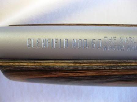

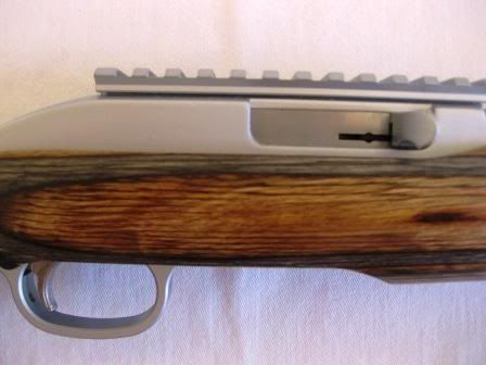

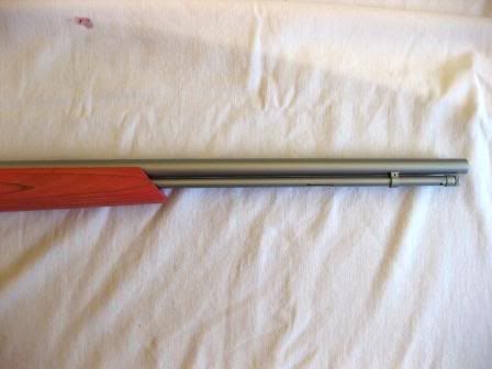

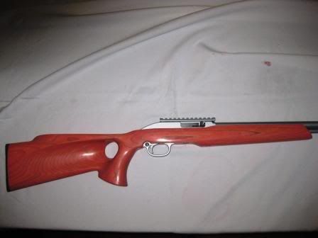

      I would look into Duracoat it is a paint with a harder that holds up much better than your standard paint. I have two toned my Sig and turned my daughters Glenfeild 60 into a stainless beauty. The key is to prep well gently scuffing up the surface with out making and scratches because they will show up. Clean the whole gun down with a degreaser that leaves no residue. And use a good quality air brush.
      I don't have pictures of the Sig, but here are pics of my daughters Glenfeild.
      I found a poor picture that I had to crop from a family photo.
