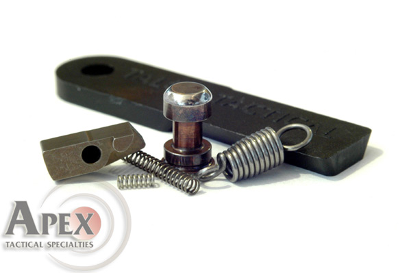

    I'm looking for a gunsmith that can install an APEX 45 Duty/Carry Action Enhancement Kit (DCAEK) for me. Preferably in the LA-OC-IE county area. Private or Commercial business is fine as long as they do a good job and guarantee their work. Thanks!

    Have you thought about doing it yourself? The parts are drop-in and only take about 15 mins.

        The APEX parts are drop-in easy. Take your time and do it yourself.

                        You can install it yourself or ship it as well.
                        You can read this to tie you over
                        On Duty with Apex Tactical’s DCAEK
                        Following thorough testing and evaluation by their Lead Firearms Instructor, the Port Authority of Allegheny County, PA has officially approved the Apex Tactical Specialties DCAEK for use in Duty/Off Duty S&W M&P’s for it’s officers.
                        This is a huge milestone for a small company like Apex. We’ve had numberous LE agancies across the country request and receive T&E samples of our DCAEK and this is the first one to officially add the DCAEK to their list of permitted modifications.
                        I'm glad I shipped it to them personally, some of my stock parts were slightly out of spec and they adjusted it for me no charge

                            Here is one of the rare issues some are running into:
                            [quote name='Randy Lee' date='Sep 9 2010, 08:04 AM' post='271111']
                            Greetings,
                            We have been investigating the problem for a little while and have isolated a few causes. Sear spring dimension, vertical tolerance between slide and frame coupled with the non-stock sear geometry such as ours and the pro sear all contribute to the dead trigger.
                            The primary culprit is sear bounce during recoil. My personal feeling is that the sear spring is not of adequate size to stabilize the sear during recoil, especially in the .40,.357 and .45s- moreso with the compacts.
                            The North Carolina State Police had issues with this as they use the .357 Sig caliber. The factory solution to the problem was to retrofit the pistols with a sear housing block similar if not identical to tha MA compliant version, and a new trigger assembly. The larger sear spring and plunger helps retard the inertial bounce by applying more adequate upward pressure to the sear.
                            The vertical tolerance between the slide and frame can vary as much as .015 or more (in some of the guns I've measured). When you figure that I established our sear to have .040" of sear/striker engagement and you lose almost half of that due to overly generous slide to frame vertical spacing- sear bounce becomes an
                            issue of great concern. Regardless of what some LE sales reps are telling their customers-that our sears are the culprit, our sears are not the problem.
                            Of all the sears we have sold, we know of less than 20 instances of dead triggers. Of those, I have inspected 7 and found all of them to have slide/frame gaps that measured .010-.018 greater than our other test pistols.
                            The Pro series pistols have been around for a while longer than our sear and reports of dead triggers have been reported since its introduction.
                            In most of the dead trigger reports, the sear is bouncing enough to let the trigger bar slip back under the sear. This effectively prevents the sear from recovering to full height. This is why many report that they detect no feeling of trigger reset when they release the trigger after the malfunction occurs. The trigger bar is already positioned under the sear cam as if it were ready to fire. But because the striker is already forward of the sear at this point, racking the slide is the only option to recock the striker.
                            I believe the M&P platform is an exceptional pistol. It just needs to evolve a bit more.
                            To that end, in the upcoming months we will be producing our own proprietary solutions.
                            Until then I encourage anyone who is experiencing a dead trigger with our sear to contact me directly.
                            randy@apextactical.com
                            -Randy
                            [/quote]
