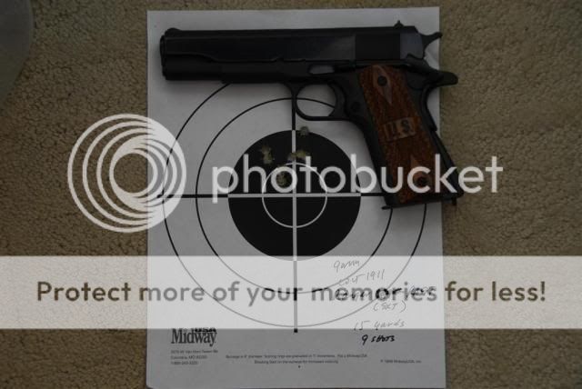

        I have a Springfield 1911A1 in 45 Auto. I bought a Colt Series 70 9mm slide assembly and put one together myself. Total cost? A lot less than what you pay for a new ones, and it shoots well.
