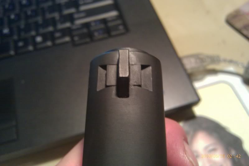

    Anyways Im sure a lot of you know I picked up a new 1911, still having problems with it. So did some more range tests, and I realized that for some reason no matter what, my bore sighter will not give me my true point of aim. Now its not the bore sighter because on my AK and my 10/22 I can hit a quarter sized bullseye from 40-50 yards out. I always set my sight to bore sight center, but when I go out to the range it always hits to the left, like a good 4-5 inches at only 10-15 yards!
    Now I took some pics of what I think may be the problem. It seems like the damn front sight wasn't even centered correctly from the factory. Is this regular? I mean i set my rear post many times, and at one time it seemed to be shooting great, until I moved my target back maybe 3 more yards and wham I'm off by another 2 inches.

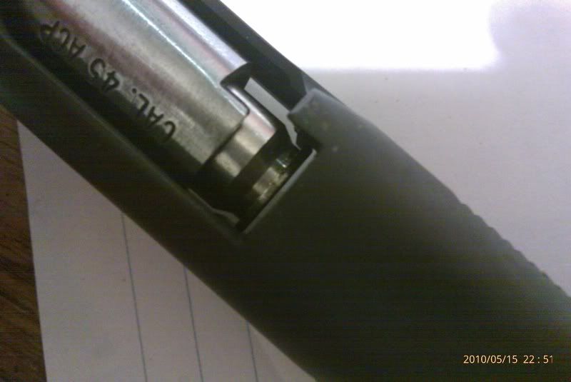

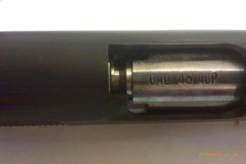

    Oh I also took pics of my extractor and such, one with the bullet chambered and barrel fully pushing against the cartridge, and one with the bullet pulled out as far as possible. Check the small gap between cartridge and slide.

    If we're assuming that you're shooting to the left, the front sight favoring left is not likely the problem. In fact, if your front sight is favoring left, the POI is actually going to be to the right; assuming no change with the rear sight.
    If the POI is just a few inches, I think it's a shooter issue.
    As long as the extractor isn't riding against the casing when chambered, you're good to go. The gap is normal.

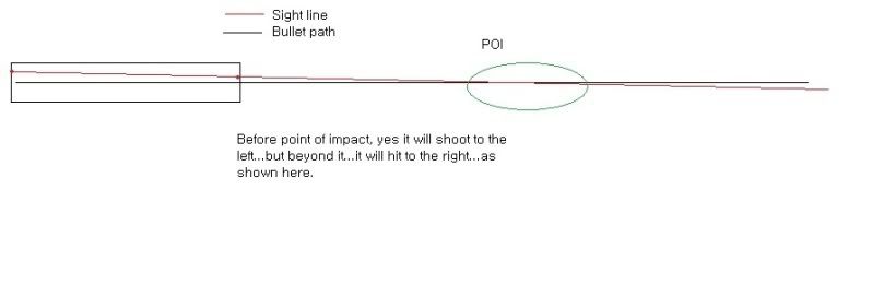

            Okay the whole front sight not having to be aligned, that really sucks because...if its not in conjunction with the barrel, yes it will initially make me shoot right...but once it hits that point of intersection with the line of sight and line of travel of barrel, anything past it will shoot left...understand my drift?
            Heres an illustration.
            Sorry! I mean to the right initially, then to the left.

                To my knowledge, this would be correct for sights or optics that are offset to the side - like a Mosin Nagant side scope mount. The scope is often off set to the left of the receiver where it's off the bore axis entirely. If it's mounted to left and zeroed at 100 yards, POI will shift to the right of target as you you hit targets further than the 100 yd. zero.
                The sights on your RIA is on the bore axis. The sights might be off and errors are exacerbated by the distance; however, the rear sight is moved in the SAME direction you wish to move the point of impact. The front sight moves the opposite direction.
                The front sight not being centered isn't an indication of a bad zero . "Mechanical zero" does not always guarantee zero.

                        My RIA tactical had front sight problems too. Blade was leaning a bit to right hand side. I really don't care since I will replace the sights anyways.

                          Is that picture of the front sight before or after you moved ?

                            All that was untouched, and still is. I did mess around with the rear sight though. I just want the sights to be directly on the bore axis...like a normal gun...that depends only on elevation as distance increases. I don't wanna have to sight my gun in at different distances, especially windage. I don't feel safe with this handgun being my personal defense if its off by windage that is distance dependent.

                            If I want to adjust my sights, the front one, all I do is tap it right? There is no pin holding it in place or anything right?
