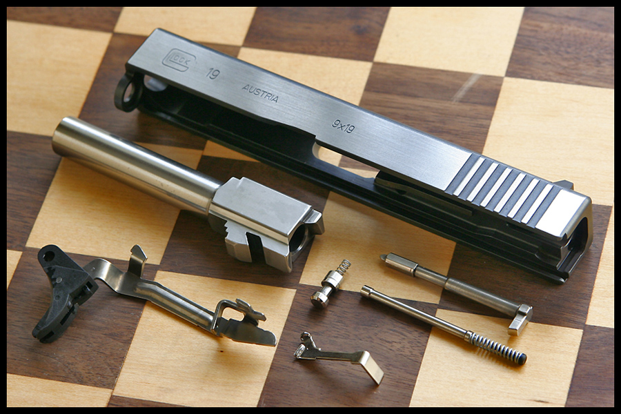

              Did this to my G19 earlier this year....
                2wheelryder88
                • 89
                Originally posted by OutlawDon
                that looks sweet! i have a feeling if i get bored enough ill ended up doing that

                        I prefer outlawdons glock finish to the standard. I had mine hard chromed by enterprise and almost all glock guys I meet want it....

                            I polished my G27 barrel along with other parts. I sold it though about 6-7 months back to a Calgunner. I just used a dremel with a polish wheel and some turtle wax. Worked like a charm. I've done about 3 barrels this way and all have looked great.
                            If you ever want to do your slide like in the pictures on the first page be sure to used a glass sheet as a work top. Tape the sand paper to the glass and wet it down. Run the slide up and down on the paper and NEVER in circles. Start with a lowish grit and work your way up till you get the polish you want. Let me warn you though about polishing the slide, it will not resist rust like it used to. The higher you polish it the less rust you will build but it will need constant care esp if you plan to carry it IWB. The oil from your skin will increase the rust time.
                              i really like the way the came out. its pretty much exactly what i want to do to my glock
