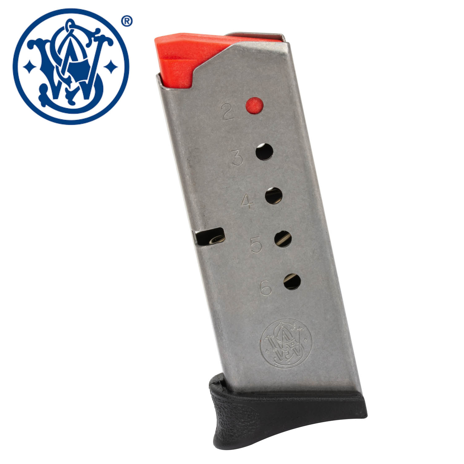

        This is a S&W Bodyguard .380 ACP 6-round magazine from ProMag. Specifically engineered for concealed carry and personal defense

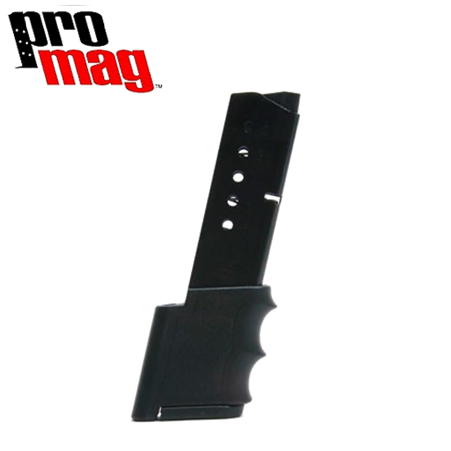

        This is a ProMag 10-round extended magazine with finger extension for the S&W Bodyguard .380 ACP. This ultrareliable centerfire
