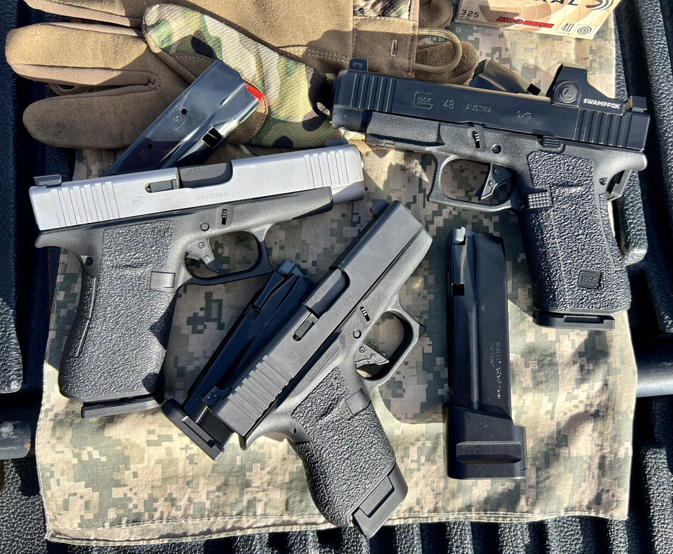

    I love everything about my G48 except the stock trigger. I bought a Ghost connector and I am quite happy with it. It went from having the worst trigger of all my Glocks to the best, although that might not mean all that much as I tend to leave my carry guns stock and this is the only one I have altered in any way. I did put a set of Handleitgrips rubber grip tape set on it from ebay to make it easier to hold if my hands are sweaty.
    I have had it for almost three years now and it is my main EDC. I use Shield Arms 15 round magazines (and mag release) in it and have never had a failure of any sort. I usually make it out to the range one or two times a week and at this point have probably run 3-4 thousand rounds through it. It is like all my other Glocks in that it is boringly reliable.
